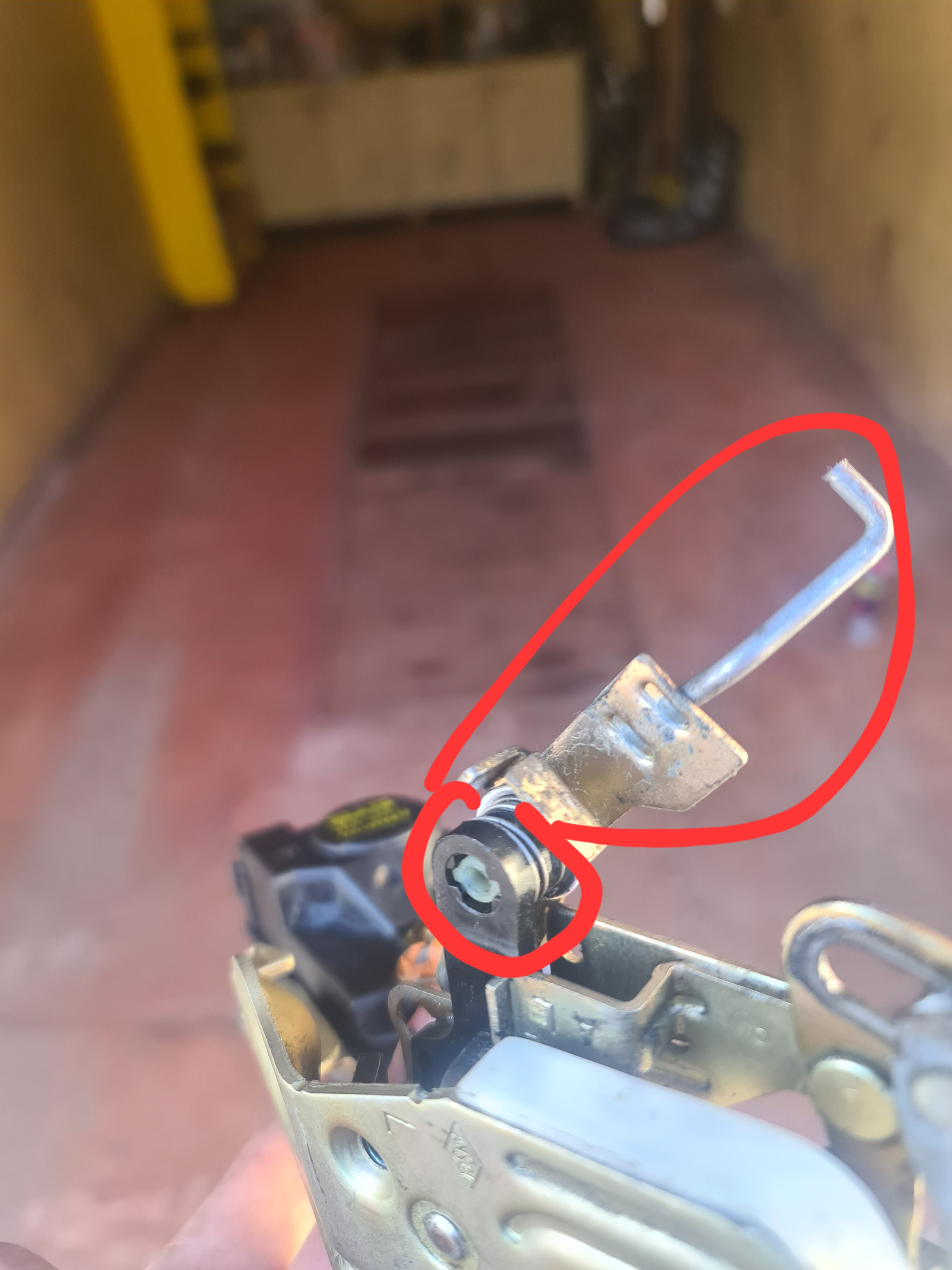

On the screen it’s marked what should be removed from old actuator.

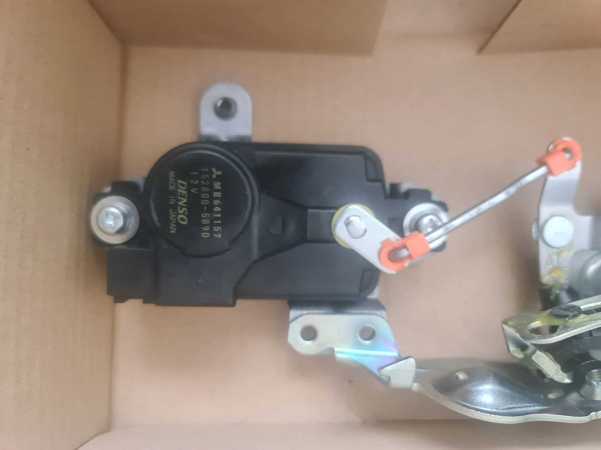

Also, a brand new actuator looks like this, I hope it’s in the open state by default. Can someone confirm ? When I took my old off the position matched with a new one.
