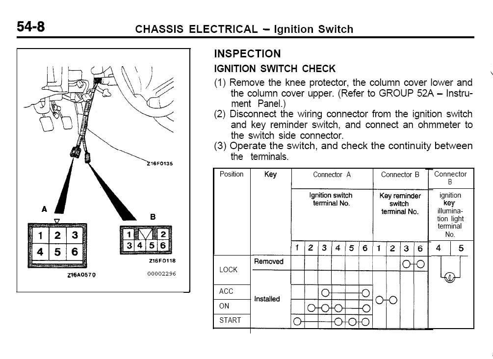

Long shot here … have you tried testing the ignition switch before and after stalling ? I’ll try and find the test sequence.
check ignition switch in particular connector A and terminals 2,3,4 and 6
