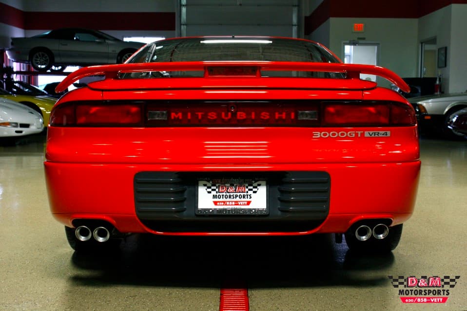

Can anyone confirm the correct color paint and finish type that was originally used for 1st Gen bumper trim (the “mustache” on the front and the license plate trim on the back).
For reference, here’s some pictures of a pristine low-miles, all-original 1993 VR4 I found online. The photos seem to generally be a bit “dark” in lighting/exposure, so I think the trim colors artificially appear more black than gray in these pictures. It looks like a dark satin gray to me.

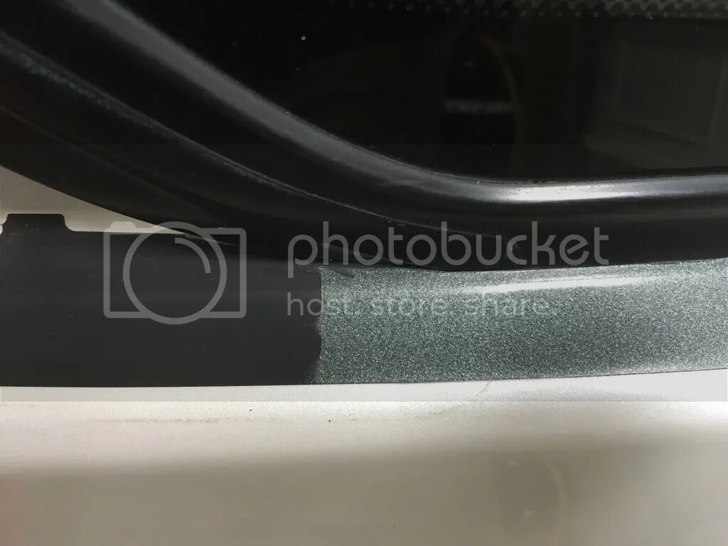

I also found an old forum thread where someone had the rear hatch trim paint color matched, and discovered it was General Motors color, Medium Spiral Gray, paint code WA812K. I wonder if it is the same color for the bumper trim? Except that the rear hatch trim seems more matte than satin.
The matte vs satin could come down to material differences (metal vs plastic) or it could be down to a cleatcoat difference.
I just found a post in that old thread where someone ordered the WA812K paint, and it was not the right color. It had a ton of metal flake: https://www.3si.org/threads/repainting-the-rear-hatch-gray-trim-the-right-way.424795/page-2#post-9346657
So now I’m back to square one hoping that someone has a confirmed color match.
