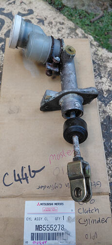

Hello all my name is Lee, I have a 1998 Mitsubishi GTO SR. As this part is obsolete now, I have decided to refurbish an old one I kept. I have bought an OEM Spring kit to replace the old one with. The only problem is I can’t get the old one out. It pushes in as it should but I can’t figure out getting it out. Ive tried using compressed air to blast it out but no joy.
Does anyone have any idea how I can do this? thanks

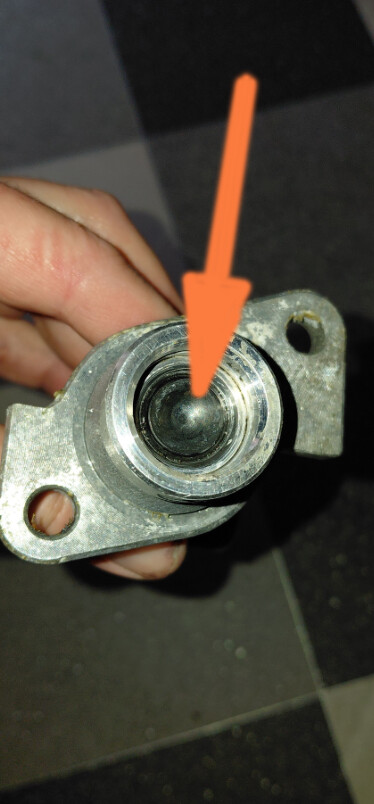

Hi Joe, there was a split ring - I removed that. I thought it would come out easily after I removed it. I can’t see anything to help bring the piston/spring out - it’s just wedged in so tightly. This master cylinder is different to other gto/3000gt cylinders too - there is literally non for sale anywhere / no alternative. thanks

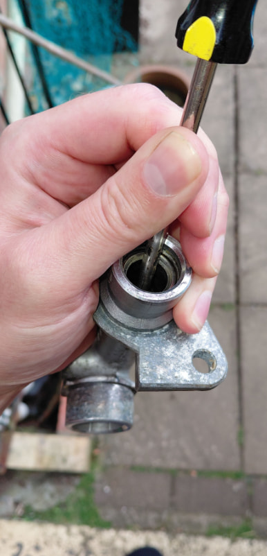

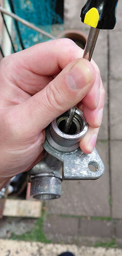

Its sorted! I just kept pushing it in as hard as possible many, many times and eventually it pushed out so much I could get some leverage with a screwdriver to pull it out! thanks

Literally can’t find the right one anywear. For the SR - the part is different form all other 3000gt/GTOs. the bracket is on an angle - all other master cylinders have a straight bracket. Ive realised refurbishing one isn’t too hard so not all is lost. cheers
