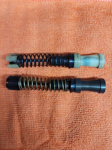

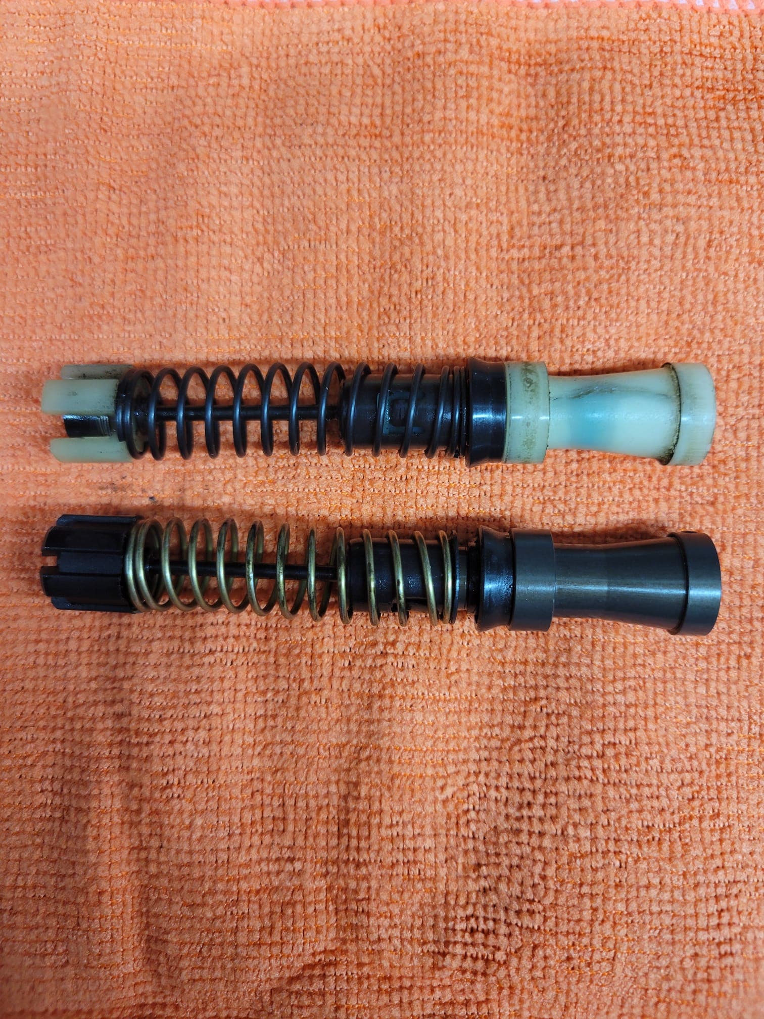

Well, some time has passed, but I now believe I have a solution to this
This is a pic of a typical std failure part, you can see the split in the white plastic.
The below is my alternative
I will be testing this on my GTO very shortly, and will report back with the results
If this works as expected, then this will provide a solution to an issue that otherwise will start to take these cars off the road
Marty
I have now installed this on my car.
Works perfectly fine, and these are now available
Marty
