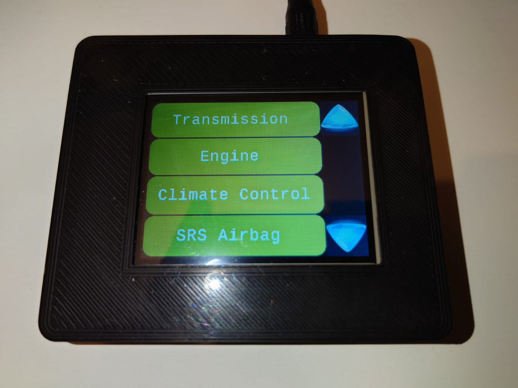

also if your thinging of buying a code reader, buy the blackstealth one, there sold on ebay and come from the states, it does everything the MUT tool does and will read every module on the car, does test functions and will clear codes and faults,
I have one and can well recomend it
cheers
Joe
Hi, do you have a link for that?
HI
Message him on ebay, blackstealthtech on eBay
cheers
Joe
How much is this to buy typically? I have wanted one of these for a while now. thanks
Hi
Sure I paid $300 dollars for it and in came in just a week
very good and user friendly
