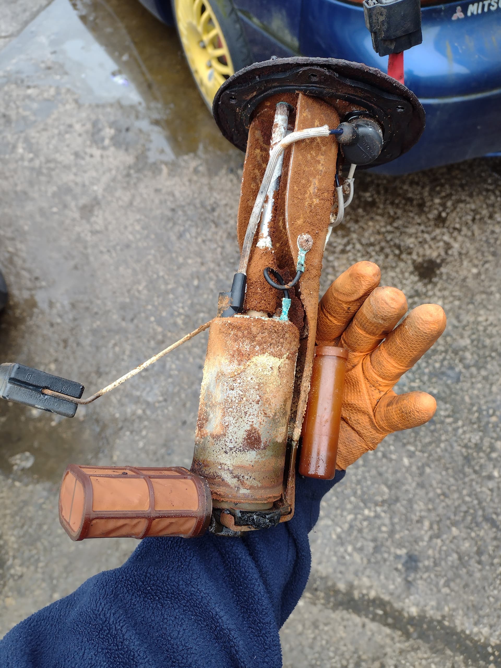

You can run a length of wire from the battery + terminal to the small BLACK fuel pump test connector where the washer fluid comes up, theres a bunch of connectors. This will run the fuel pump and you will hear fuel running through the fuel rails etc. You should also be able to hear the pump in the tank. If you hear nothing, then the fuel pump is likely dead and if the car has been stood a while it will likely be due to rust/corrosion.
This was the fuel sender out of my 3000GT that had been stood 5+ years with some fuel left in the tank…
Be mindful that removing the fuel sender unit, can lead to more repairs, to the tank studs, fuel line and even the fuel sender itself if it is badly corroded and weak. Google is your friend for advice on how to remove the fuel sender unit with the least risk of snapped pipework. Good luck!

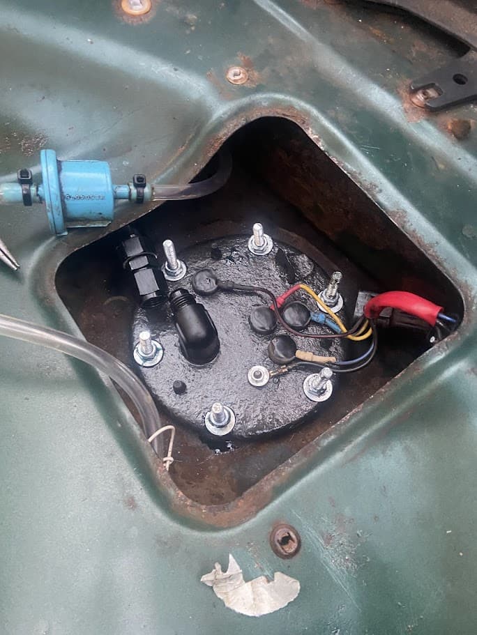

We also tried unplugging the fuel line right as it comes out of the fuel pump and stuck it into an empty bottle, cranked for a sec, no fuel spat out. Leaving me to think it’s a fuel issue - this was the intuitive way for me to test it. I think what I’m going to do is try and wire up a direct connection to the fuel pump.

Is that clear PVC pipe, are you sure that is fuel vapour safe?

The previous owner did all the work on the fuel lines. I believe that line is in charge of maintaining pressure or something? The blue thing that looks like a filter is actually a pressure valve after some research. So, maybe. I trust the previous owner, not sure why they’d consciously go ahead with the whole thing knowing that it might be unsafe. It is a big job

I’ll rephrase my comment; It is VERY unlikely that the clear pipe is fuel safe long term (even vapour) - so unless you know for sure what the specifications of that pipe are - you should replace it with fuel safe pipe as soon as possible.
