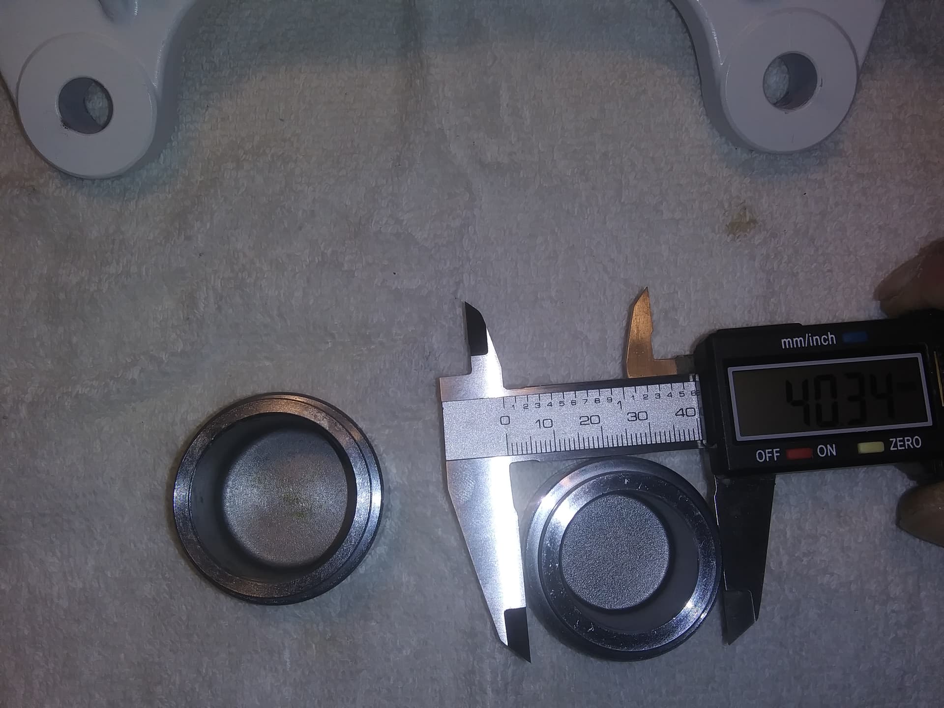

I shall send you all the measurements of the pistons tomorrow have to get a battery for my digital caliper dont have one around the house.
Thanks alot mate really appreciate it
Hi so here are the measurements. FYI as i mentioned earlier, the pistons and caliper housing are NOT the same size, and three dots seen on the piston head perhaps represent size difference so when you get a new complete kit also make sure that the seals which have color coding on them go in the correct size housing or you will have serious issues with brake fluid leaks and perhaps brake failure.
