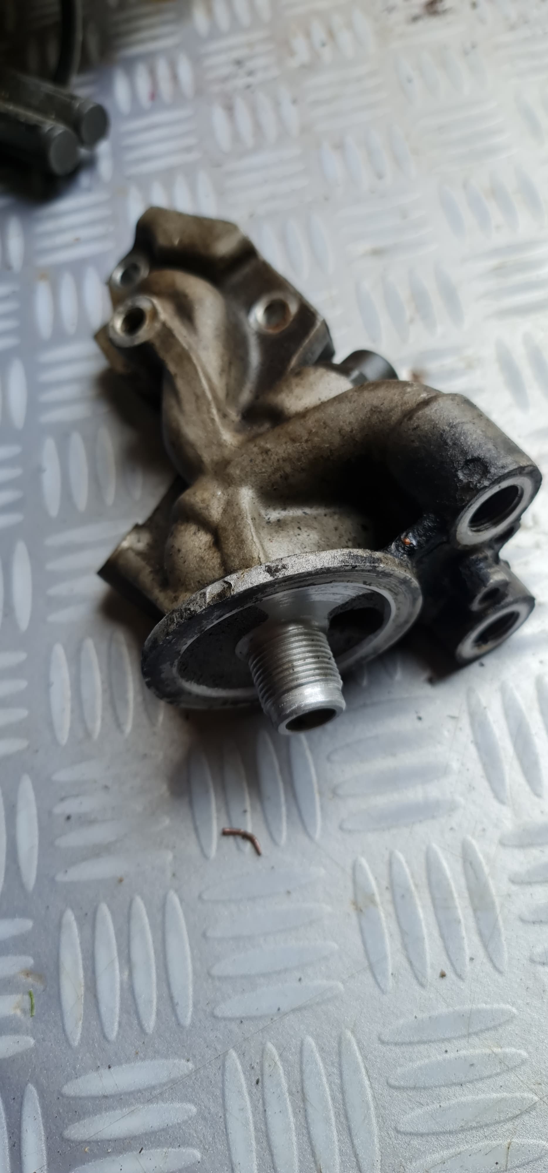

Is tis what you want?
Hi,
Thats thre part. Let me know how much and deluvert cost. I live in W Sussex if that is helpful. Regards Derek
£25 including postage if you want it
Just need address and mobile number …and how you want to pay…bank transfer is good
