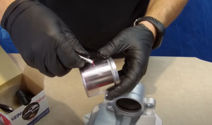

Hi Guys,I wonder could someone advise me on the following. I am in the middle of refurbishing my front Brake calipers and having searched online I am getting conflicting information regarding what to put on the brake pistons when re-assemling them back into the Calipers. as per picture from Youtube.
Some are saying Use brake fluid only, others say Brake assembly grease or other such.
Can anyone please advise ?
