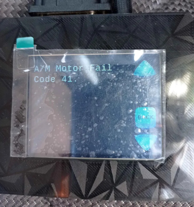

  • Using the scan tool, there is an intermittent error code for one of the air mixture matrix blower things (see pic below). This is the only error code but doesn’t appear all the time.

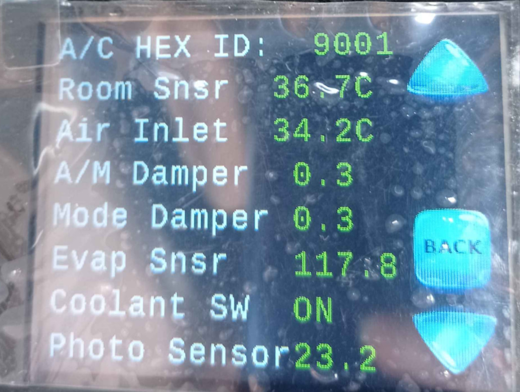

  • The main climate control read out from the scan tool is below:

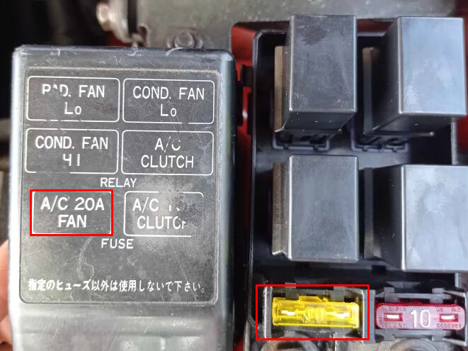

  • When I got the car, I noticed the AC fan fuse was missing so this has been replaced.

The air mixer motor. Does your car blow cold air and move from hot to cold OK? Don’t need the AC once for this.
basically behind the AC display there is a little flap/ mixer motor that the either allows air to pass over a little radiator for hot air and bypass it for cold air. This was a problem on my car as the air was always on hot! I swapped the motor and you can test it before putting all the centre vents/ radio and ac control unit back by just setting to hot and cold and watching the motor move.
James
Thanks for the response. I think if my mixer motor is indeed faulty it would at least imply it’s not delivering the correct amount of hot air so the opposite of your case since it was fully cold but not fully hot back in winter.
In winter I was getting cold (ambient) air on the coldest setting and then warmish air on the hottest setting (I thought due to a clogged heater core). I’ll have a look to see if the motor is doing its job as that could explain things.
