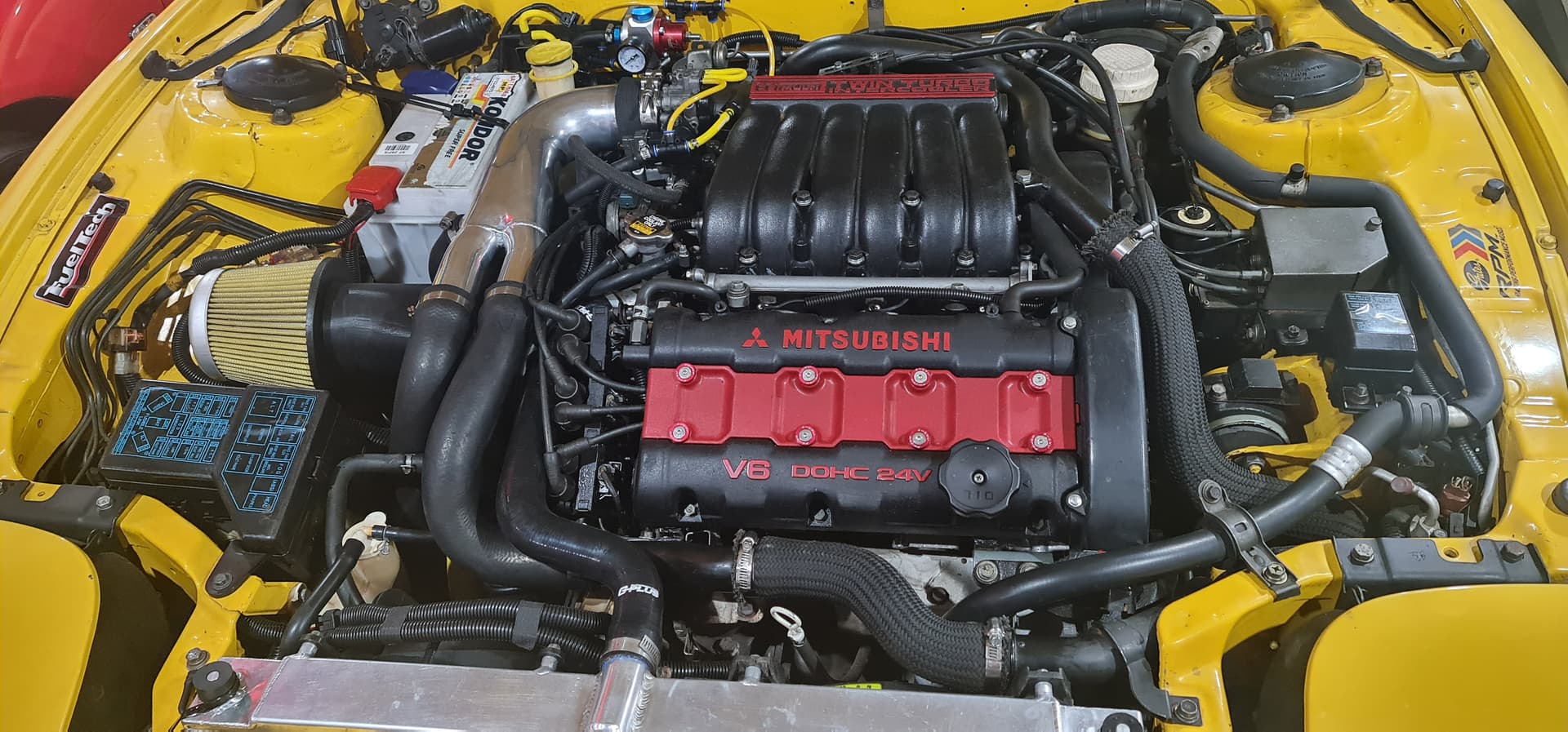

Hello, when I purchased the car, it came with a poorly installed aftermarket injection. Good quality equipment, but a mess regrading to installation, bad grounding, routing and bad connections. Moreover the car was blind to important parameters, I took everything a part and started from scratch adding what was missing:
Oil pressure, Fuel pressure and Idle Air Controller, were not installed or functional, I also add a wide band and knock meter to properly tune the engine.

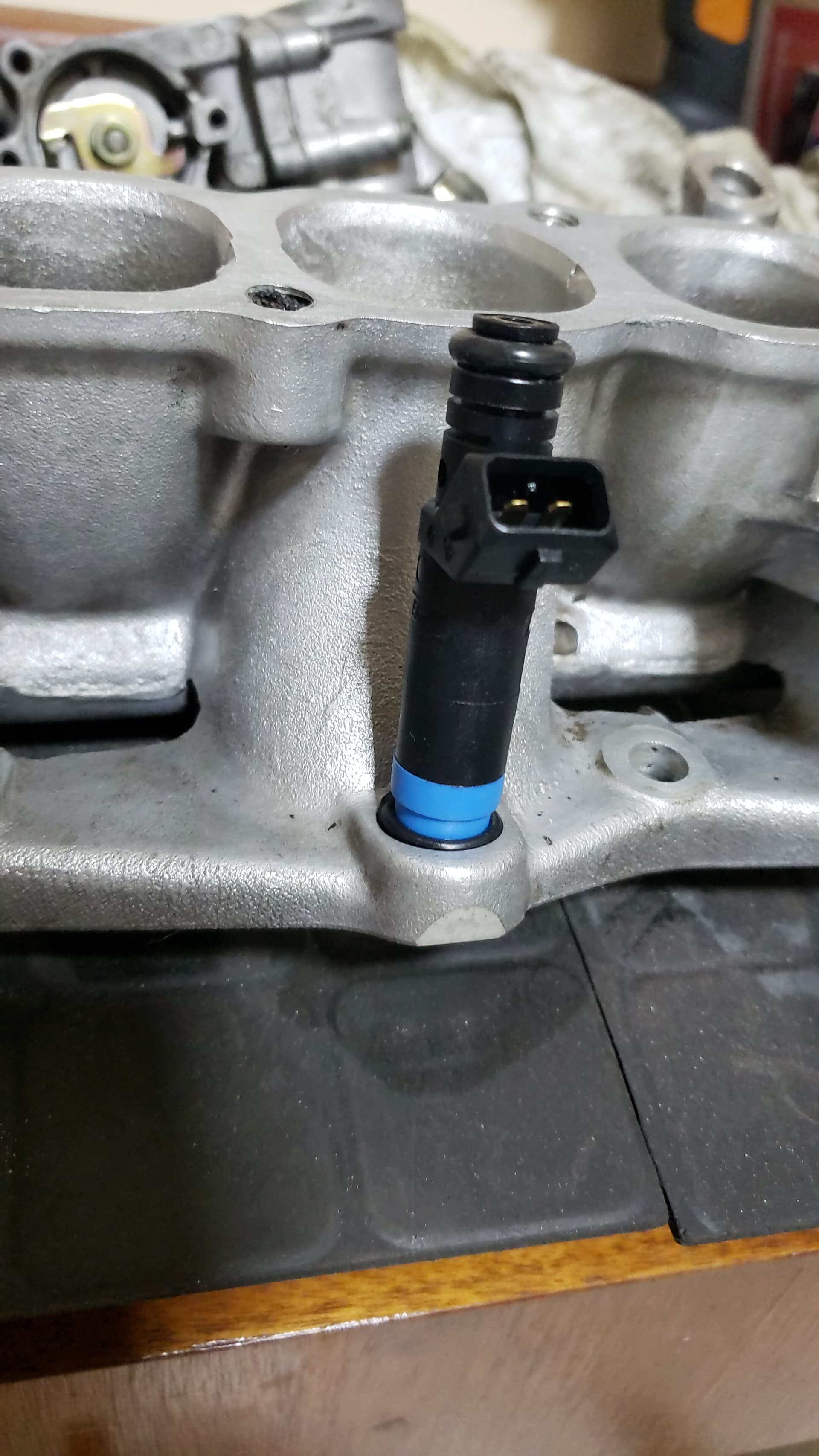

Added a two step lauch control, with a switch on the panel plus a buttom at the shift knob, so you need to activate both to enable it. The car is running on Alcohol, but I didn’t upgrade turbine, pistons or anything like that, replaced the hydraulic lifters to the wide bore version. Injectors Deka 80 high impedance due to the fuel management restriction, low impedance (standard) can’t be used. Aluminum cooler (radiator) and I had used the mitsubishi Airtrek 2008 fans which has brushless motors, not sure the model car has the same name out from Brazil, once I’m using the injection to control when each fan kicks in, I’liking the response of the coolers, specially where I leave once we have average temperatures at 27 C for the most of the year.
I believe I reach a good adjustment but, I’m planning to take to the dyno to improve a bit.

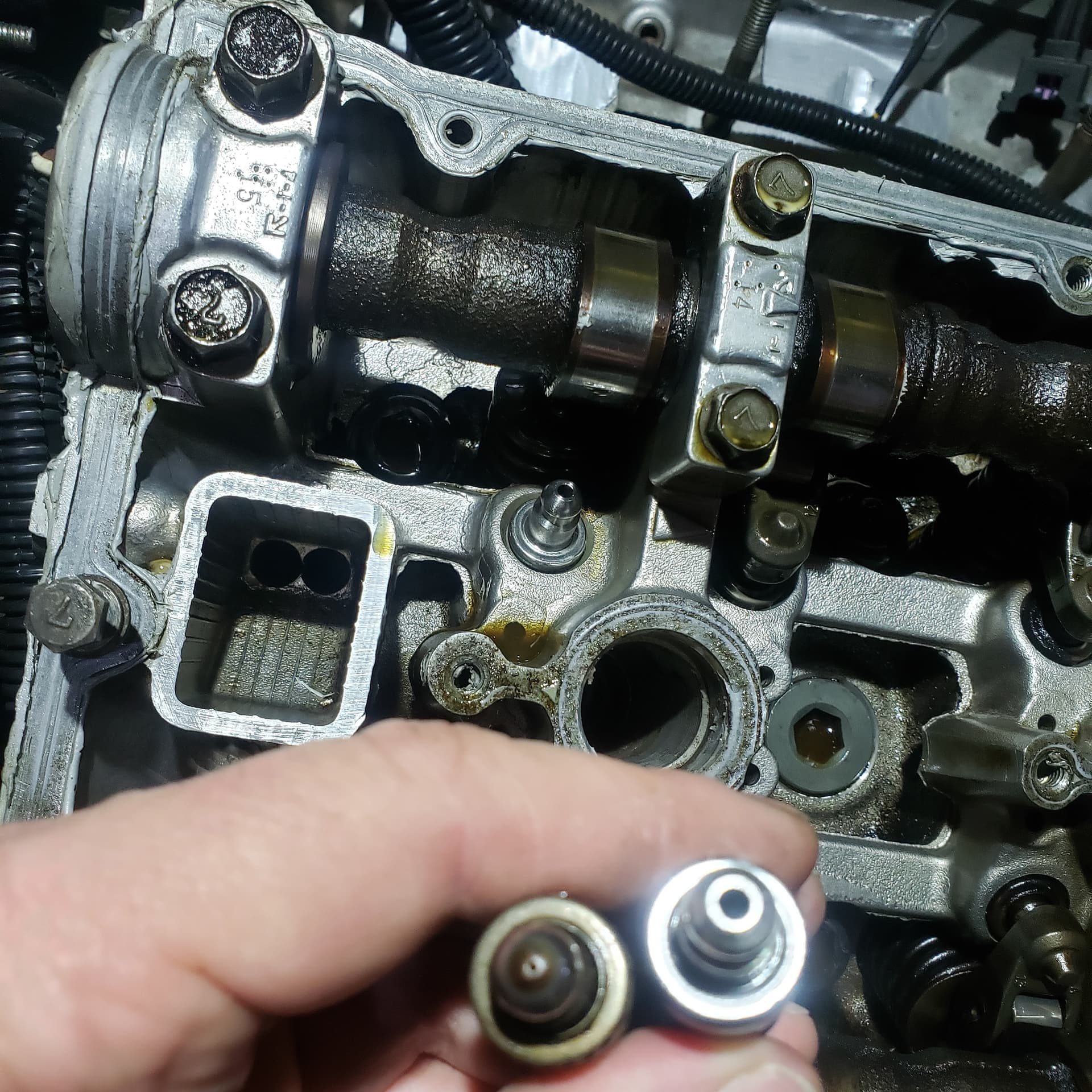

Very nice and clean engine bay, good job done. So I understand as far as the engine is concerned it has all stock internals, except for big bore lifters? was the engine pulled out and everything inspected? did you do it yourself or a shop? how many miles on the engine?
Thanks, yes, mostly stock internals, the car has 74k miles on it. I inspect without pulling out. Replaced belts, water pump, serviced the alternator, the car is free of leaks and smoke. I forgot to mention I had cat delete with 3" stainless steel pipes all the way, with two mufflers in between.
