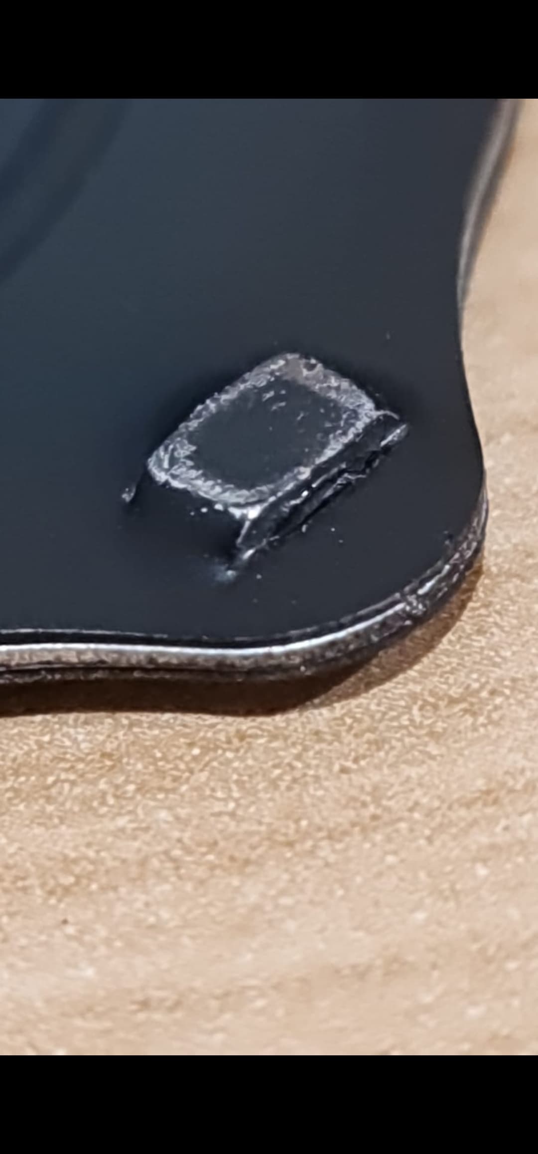

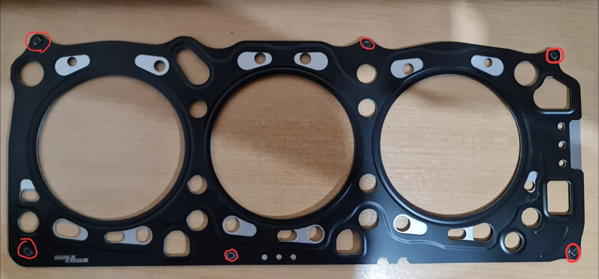

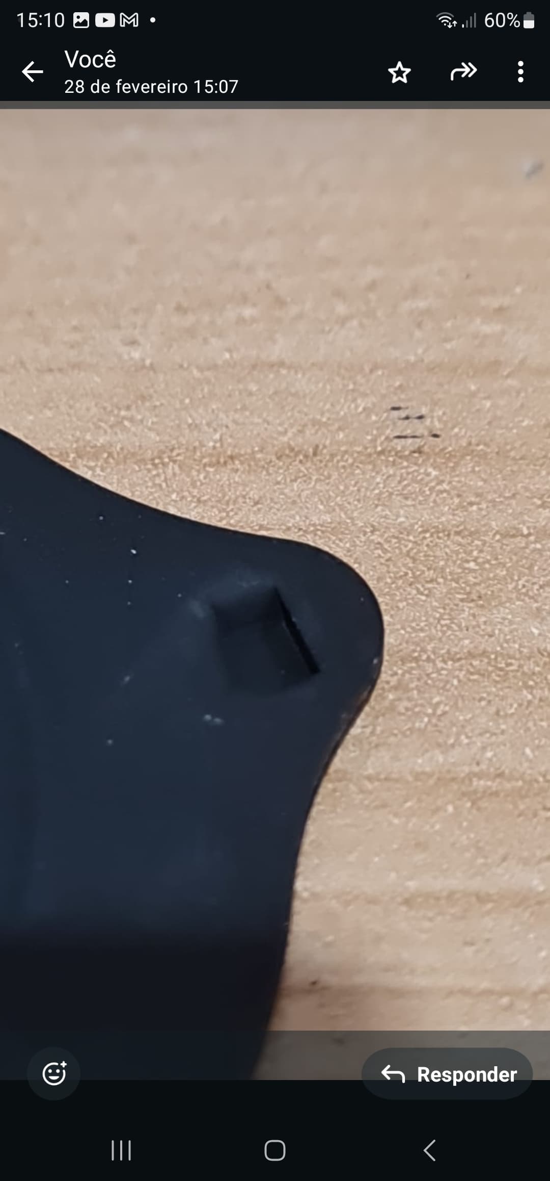

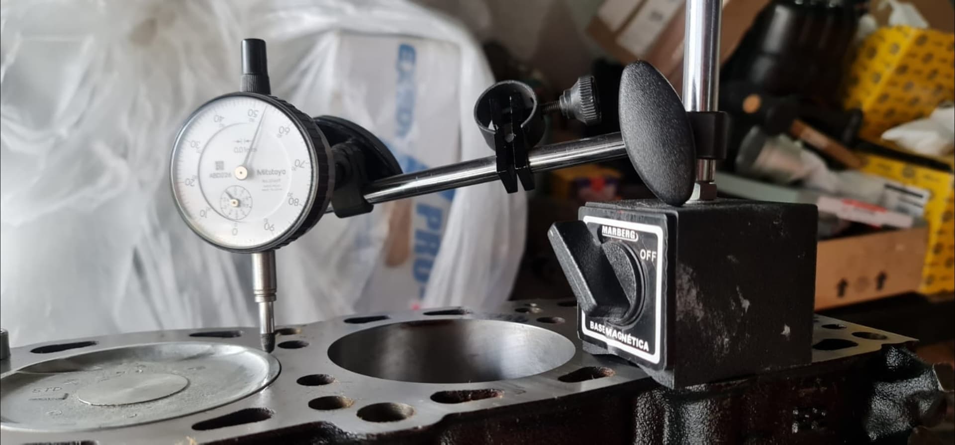

I’m assembling my engine for a quite time so far. Unfortunately the machine shop take so much height from block’s deck, so I have now front deck with pistons passing 5 tenths of milimiter while rear deck, pistons are passing 4.2 tenths of milimiter, both above the deck line.
The gaskets I have here, are 1.3mm thickness. I’m not sure if the pistons should be Zero or negative in relation to the deck. I went to some articles and I found 2 tenths as a limit however, I don’t know if would be negative, positive or if wouldn’t matter.
Does anyone has experience on that issue? I know I could get a thicker gasket, but it costing so much, bringing it to Brazil right now. So I was considering removing from the pistons crown. However, valve pockets wouldn’t worth doing.
I even consider dismantling 2 sets of gaskets to assemble a higher one, but the ones available here, are secured by hydraulic press tool, so when I tried to cut, the steel sheets bent when doing it.

Use a stock oem MLS head gasket(MITSUBISHI) HAS A 3.02MM Thickness will help you on your way .My 91 tt came with composite graphite gasket Please note do to all the decking i had to use adjustable cam gears and degree the cams if you dont your asking for the valve to kiss pistons hope this helps.
