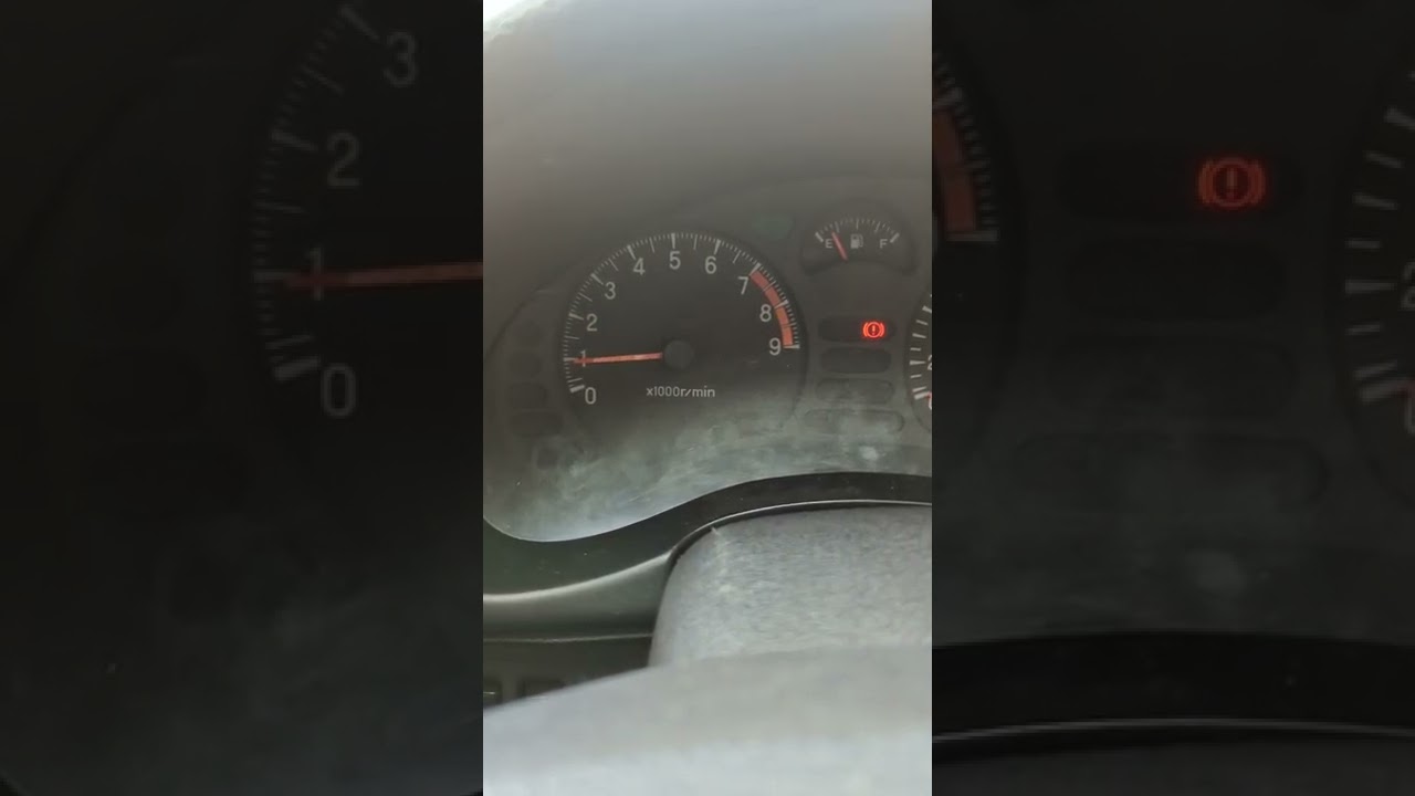

PTU did not fix the issue, canât see any obvious vacuum leaks so will do a smoke test next and see if that highlights anything
Video of whatâs happening, canât get one while driving but it does the same I clutch in to shift down coming to a stop the revs drop like that but down to 200 and it stalls
Can you take out that T piece and put back to factory like the pic. Just to see if it makes a difference. Unless youâve already tried that.
Yeah Iâve ran it standard for a while now no difference
Thought I would update, garage found a cracked nipple and a few vac lines going nowhere they replaced the nipple and old lines and then the old lines for the evap they deleted as it had been previously removed.
Car now drives great warm, sadly now struggles to keep a steady idle when cold.
