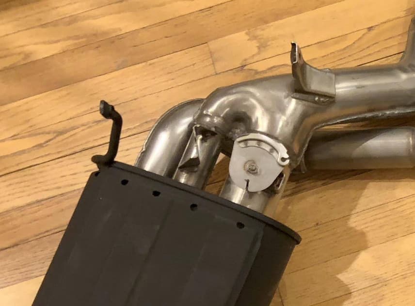

I knew you would be on it . I said to my mate I bet Andrew knows. I knew it wasn’t electrical. I think because it’s such a minor movement it’s difficult to assess its operation. I’m happy with it. I’m currently welding freeing up the active exhaust .would you have a picture of the cable bracket position, as I’m making a few brackets as the two exhausts I’m fixing have rusted away.
Thank you
I haven’t really got any pics of my own, but here’s a pic I had stored of an Active Exhaust system, showing the guide bracket and how the top valve should be oriented when it is sprung back into place.
Thank you so much Andrew, thats what I need and doesn’t that picture look superb. I don’t think I’ll get them like new but not far off.
