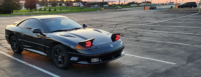

I have a: 1991 Dodge Stealth RT 185K miles
I believe I have an airflow problem. Sometimes it takes 1 minute to 30 minutes for my car to turnover. However, once it’s warmed up it starts every time. I found out if I take my air filter off it starts right away but now when I do that it seems to make no difference.
